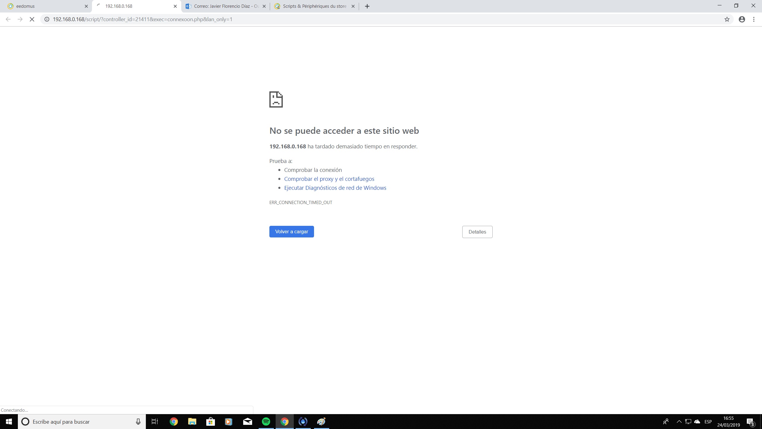

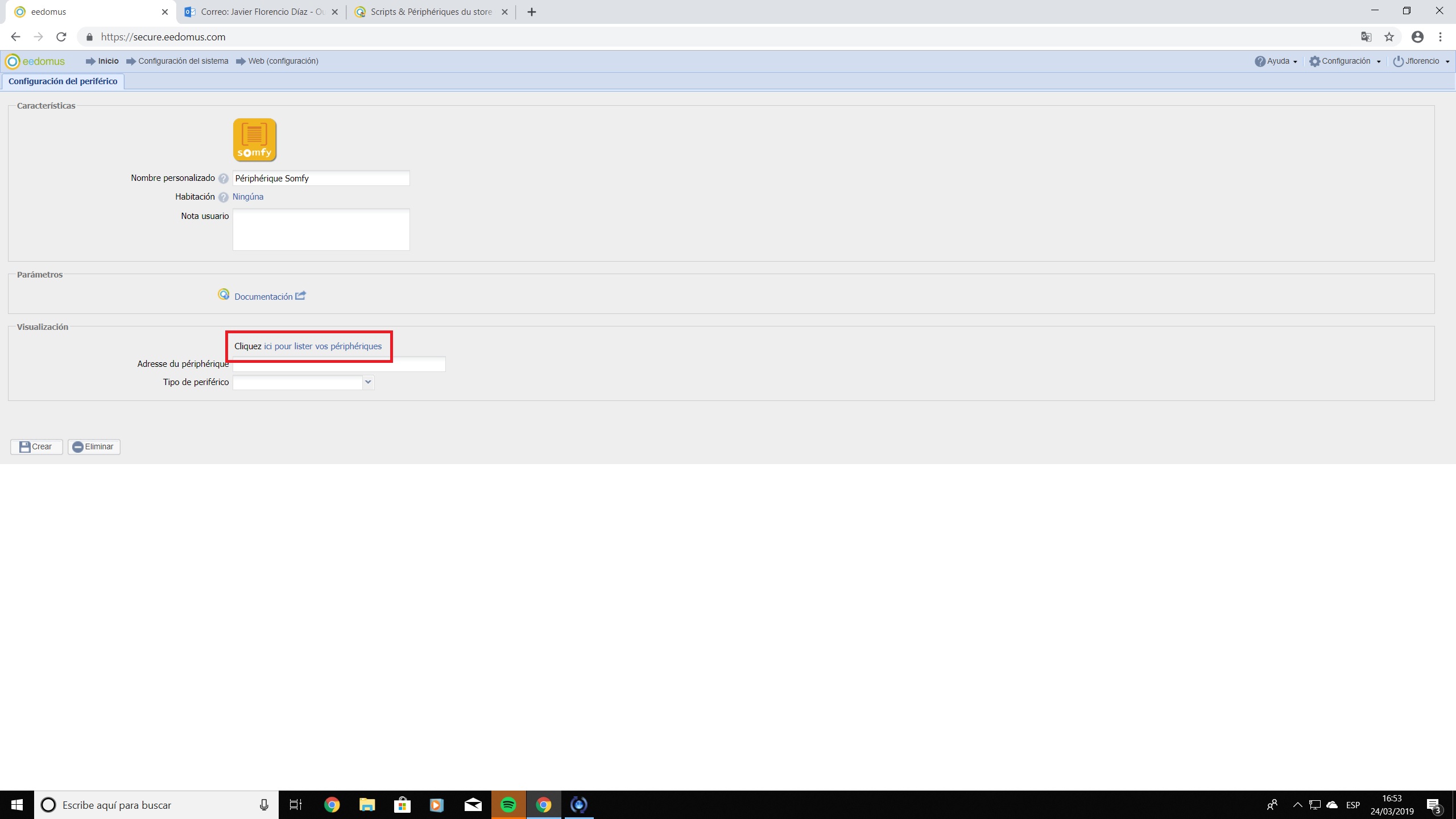

My name is Javier, from Spain, new to the forum.
I have Somy IO blinds and Somy Connexoon bridge. I have also an eedomus domotic controller I just bought and I have been able to configure light switchs successfully. I am not an expert on the controller but I have already been playing a bit with it successfully.
I have successfully connected the Connexoon to the IO blinds and can open them remotely from my mobile phone. I wanted to be able to control them from the eedomus controller to finally do it via voice with Amazon Alexa.
I have been ablet to find the "Somfy" skill in the eedomus store but when I install and try to configure it I am finding an error message when I hit the "Cliquez ici pour lister vos périphériques" link. I get a fully white error message in the browser saying that is not possible to access to the site. The link launched my browser to this address "http://192.168.0.168/script/?controller_id=21411&exec=connexoon.php&lan_only=1".
Can any body help me? merci beacoup!!
The error message I get.
In red box highlighted the link which I get an error if I click.
