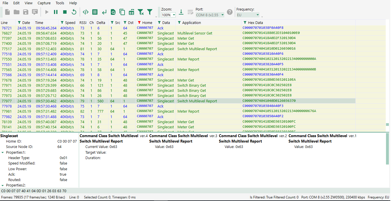

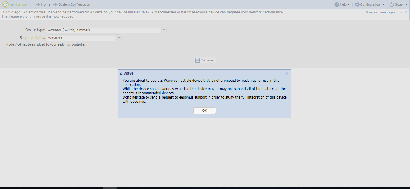

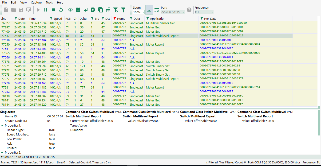

J'ai contacté QUBINO, et après plusieurs échanges, voici la réponse :
Let me explain you in few words who is responsible for which part of integration: the company that produce the gateway is responsible to properly integrate the devices that they support, on the other hand we’re responsible to make the devices on the Z-Wave alliance standards for which we get the device certified Z-Wave Certification Number: ZC10-17035480.
Here is the link to the details of the certification of our product. https://products.z-wavealliance.org/products/2252
On the other hand when installing the Din dimmer in eedomus is clearly specified that the device is not promoted by eedomus to use on their gateway, and there's also a line that say to request to their support to study the full integration of this device. We will be glad to help them to integrate our device in their gateway if they need any data they can write us and request what they need.
I include the device in the gateway and test it (screenshot in attachment) Is clearly written that the device is not fully integrated, I have logs from the packages sent and received between the gateway and our device (the one i highlight is the full and off - 00 and 63 in hex) also other reports when i was dimming was sent from our device, but because of the integration can't be displayed from the gateway.
Can you tell me where's those forums i would be glad to write a reply there too, as the information you tell me, is incorrect, we don't have a bug is the integration as explained also from the eedomus team.
Qubino support
Igor
Je transmets les coordonnées de ce forum à QUBINO et je demande à l'équipe EEDOMUS de bien vouloir se pencher sur la question.
J'aimerai que QUBINO et EEDOMUS se causent ... :idea:

La démonstation de QUBINO que eedomus ne supporte pas totalement DIN Dimmer :
