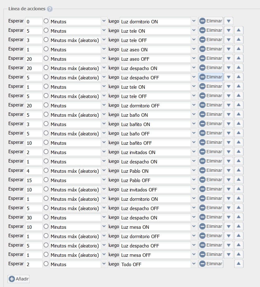

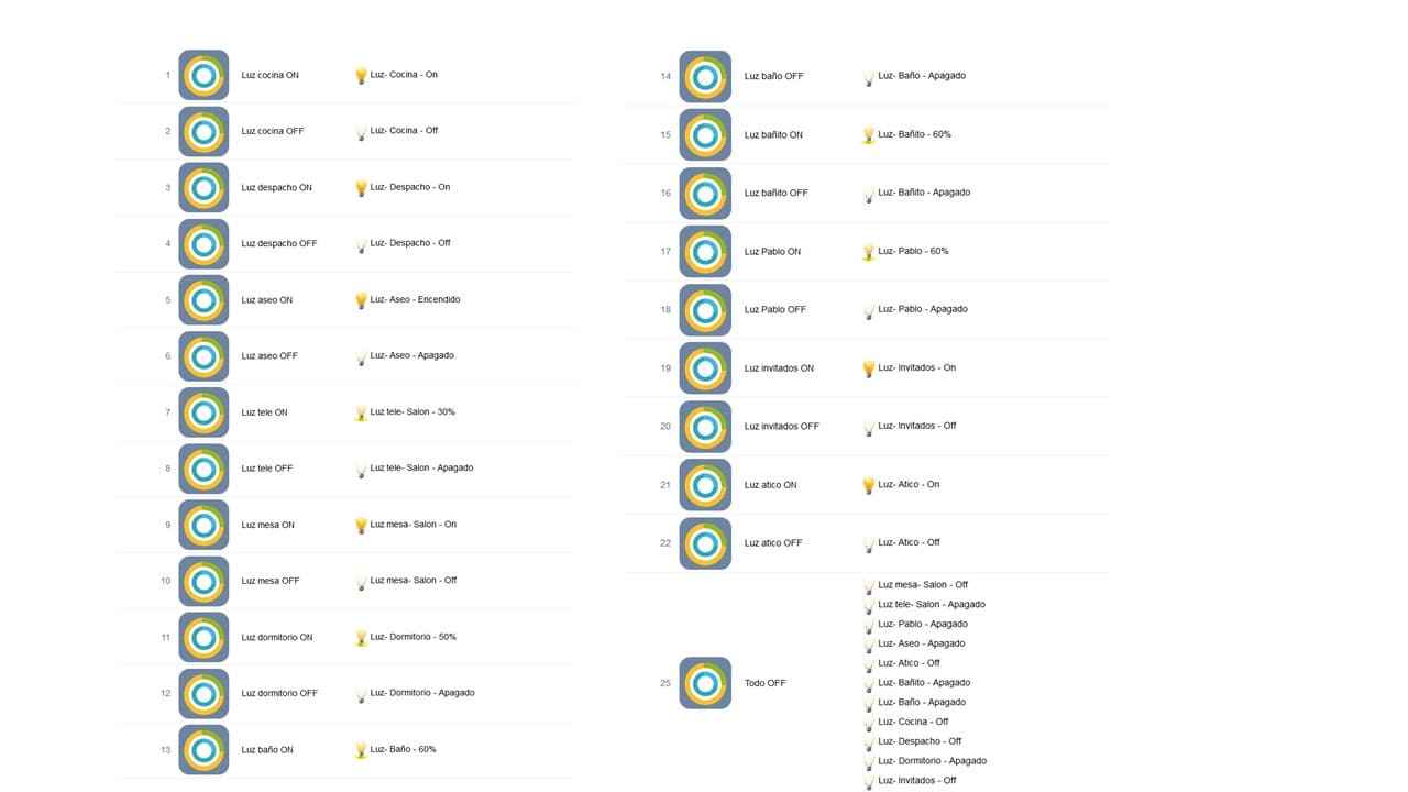

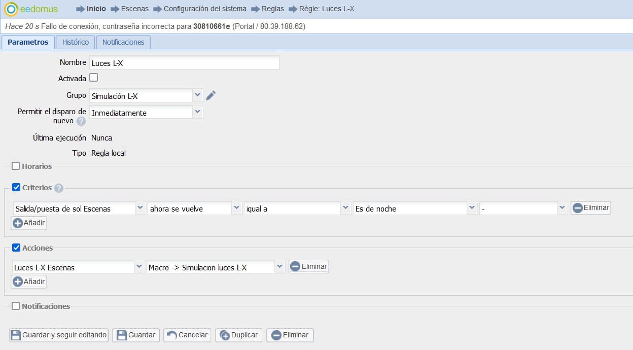

To do this, I have created a macro that affects different actuators (figures 1 and 2) and a rule that triggers the macro according to the value of the virtual peripheral "dawn / dusk" (figure 3).

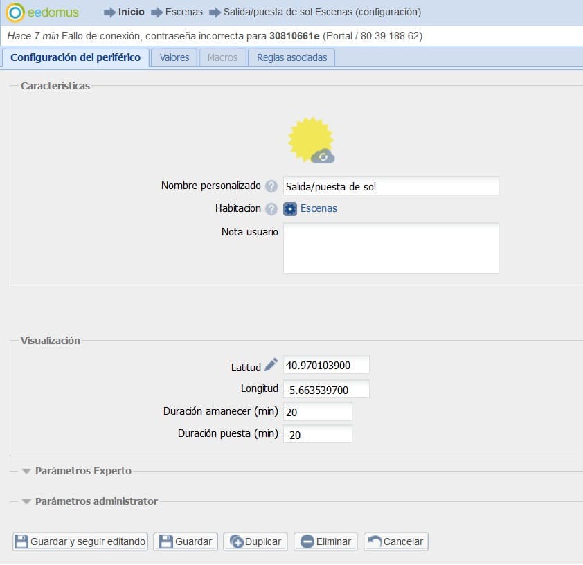

The problem I have is that the macro does not fire when it gets dark. I have verified that the macro works when I activate it "manually", so I assume that the problem must be in the virtual peripheral "dawn / dusk"; however, I think I have it well configured for my city (figure 4) and the more I think about it, the less able I am to find the problem. Can you give me a hand? Thanks!!
