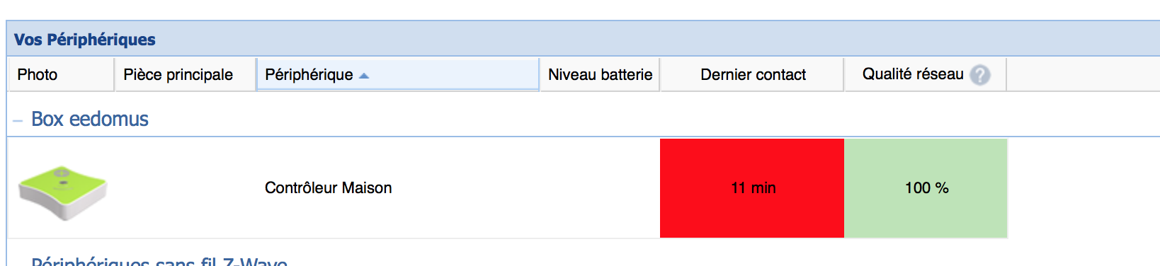

Messagepar Horia » 19 Jan 2017 20:07
Hi,
I did the software refresh.
The box handled a longer burst but finally the result was the same.
Hence, I have to say: There is a BUG out There and to continue on the pseudo lyrics from Pink Floyd, I would ask: Hey you, CO can you feel it?
Regards, Horia
