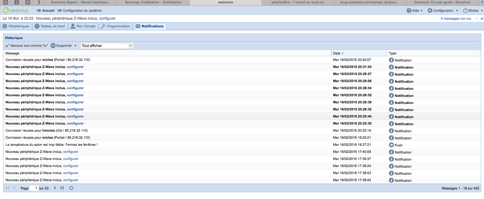

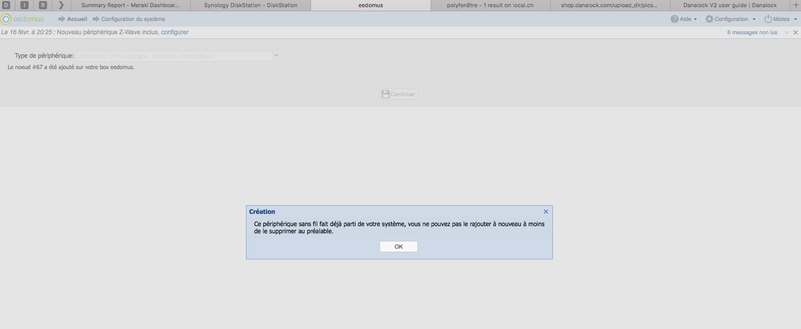

Messagepar Horia » 16 Fév 2016 21:22
Hello Bart, eeDomus Team, All,
I sent the same to the support alias on the old ticket: 8266.
I was attempting to include 30 new devices. I am facing the old bug: any new device inclusion attempt is recognised as an already included node, this time 67 (before it was 54). Obviously this time I won't attempt an exclusion to risk breaking up the system. So please help.
The support team said last:
Après analyse de votre box nous avons trouvé la cause possible du problème que vous avez rencontré, nous avons publié un patch afin d’éviter que cela ne se reproduise.
Thanks for your help, Horia
PS: Please see below my disastrous attempts.
