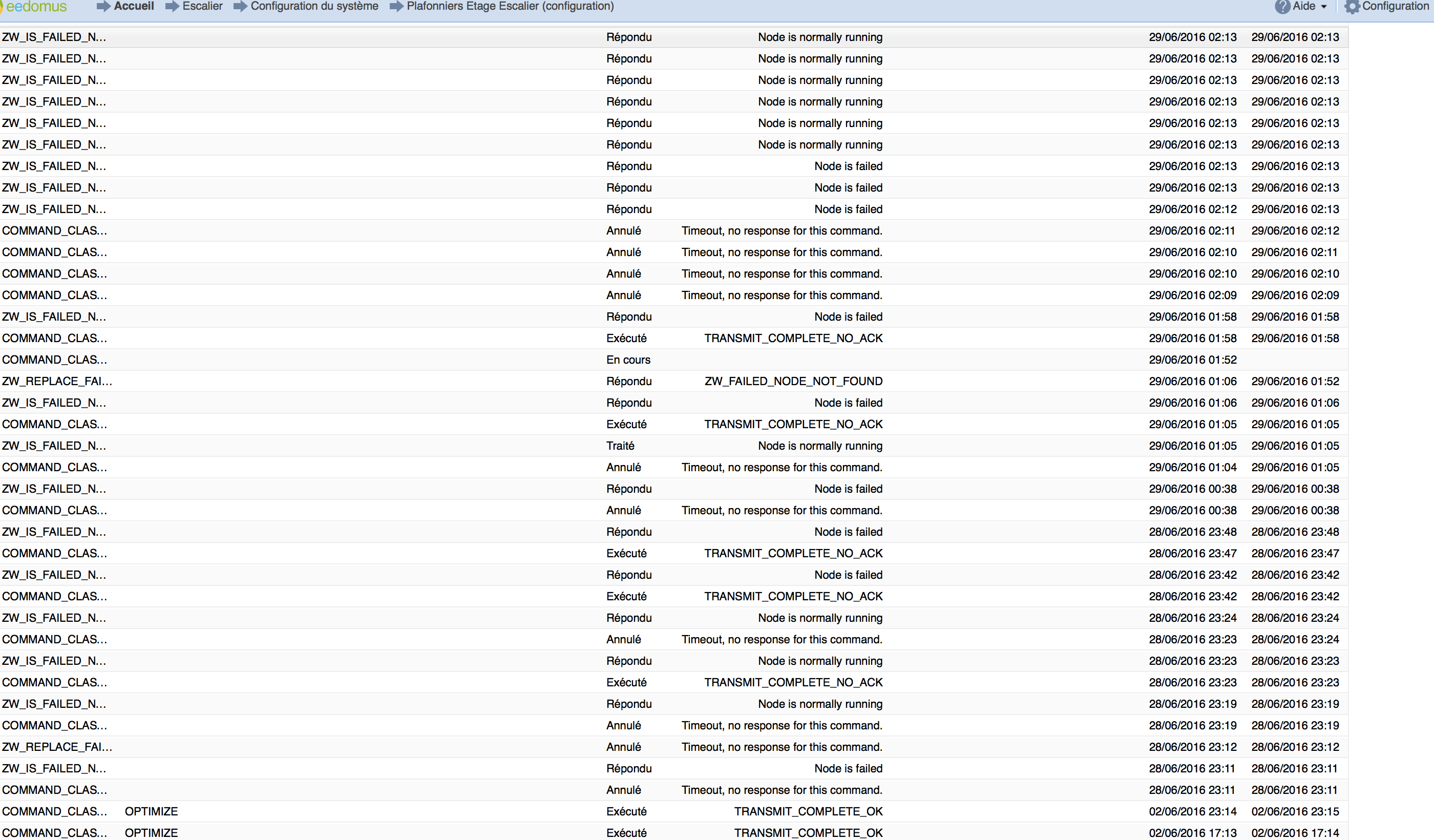

Messagepar Horia » 29 Juin 2016 01:30
Screen Shot 2016-06-29 at 02.15.40.png (574.67 Kio) Consulté 2467 fois

Messagepar Horia » 01 Juil 2016 14:25
A short update with my experience...
It all started when I decided to exclude forever 5 Vision Security Shock Sensors (always unreliable in reports and wake ups). After exclusion, 5 x Qubino relays/dimmers started to miss-behave: one got excluded, the rest misbehaved as you could see. They were still report electricity usage, but no reacting to commands or reacting unpredictably....
Finally, I excluded and re-included them. But, this only worked from the S button not from the I buttons.
From now on I think I will be very carefully selecting new modules, I plan to focus primarily on Qubino and Fibaro. I still need to integrate awnings, hence few new actuators and a weather station (I am inclining either for the Qubino's Zwave/433MHZ or for the Oregon's 433MHZ model).
Comments in this respect are welcome and I apologise to the forum managers for placing this under the box. A better fit would be under the use cases/usage section.
Thanks and best regards to all, Horia
