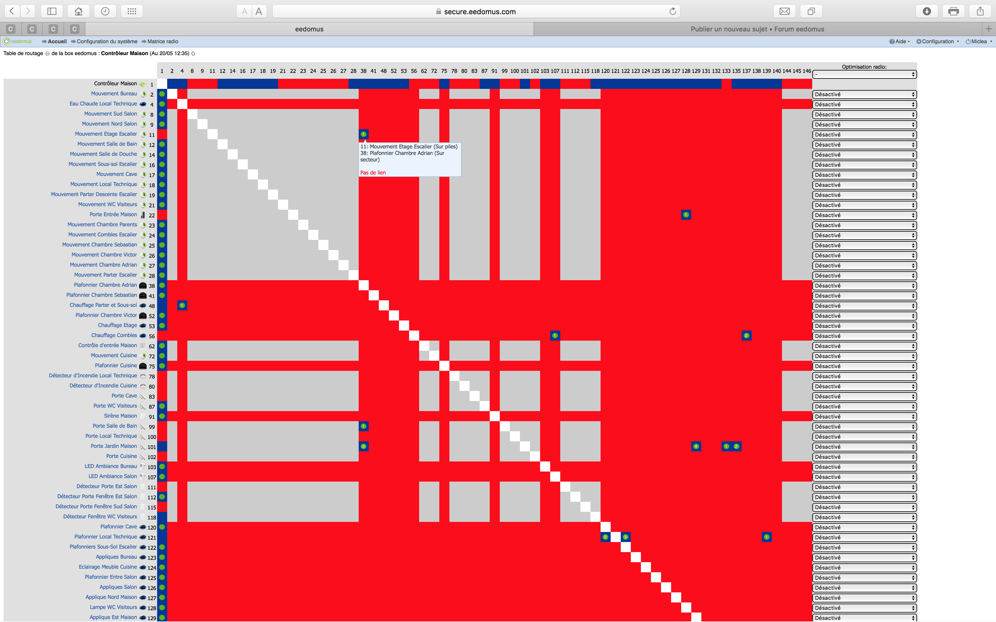

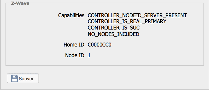

The eeDomus team advised me to reset the z-wave controller, while I had two lost/ghost nodes that the firmware failed to remove and was crashing. And so I did yesterday and I am still amazed. Here is the result:
- The z-wave configuration page says no nodes included
- Meanwhile all my nodes are alive and working slightly faster than before
- The routing table shows blue spots only for the current routes (and direct routes), meanwhile the pop up text says the opposite (no route).
- The lost nodes (that crashed the SW in the past) disappeared.
- Some of the delays I had for rule actions disappeared, others diminished.
Obviously I raised a support ticket (67409). Meanwhile for now, I have no answers. I would like to understand what happened..so if you have thoughts to share like I said I am all ears and grateful.
Thanks, Horia

Just an update. The functionality got even better after I optimised all devices (first those powered, next the battery sensors). The routing table meanwhile as before, but interestingly, now I see the direction routes between controller and devices recognised and I see the alternate routes selected a lot more logical in respect to the physical placement.
Bottom line, what I see in the user interface is a disaster but the the z-wave network reality and the functionality of the box proves the opposite.
No response yet from the eeDomus team. Maybe after all they will take a look while it seems there is something to learn about from this experience.
